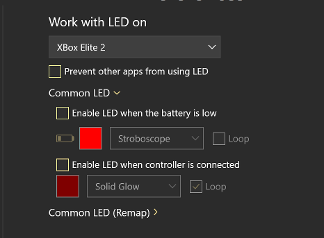

    Speaking of disabling the LED control for a specific device, while I've seen allusions to being able to do so online, I cannot figure out how to for my Xbox One controllers, such that they only way to make them behave "normally" is to set their LED to a white solid glow so that their default behavior is basically mimicked. If I go under the LED settings and uncheck everything as one post suggested, the LED simply turns off as noted before, making it look like the controller isn't even on.
    This is an example of trying this with the Elite controller (which produces the aforementioned issue):

      2) Unchecking all checkboxes for a related type of controller should prevent reWASD from doing anything to the LEDs of any controllers of that type.
      I won't be able to use the system in question again for a little bit in order to troubleshoot more, but is that not what I did as shown in the picture above? Because as mentioned that just results in the LED being completely off.

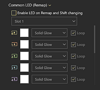

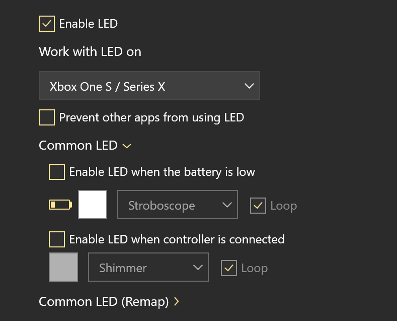

              I began by using the "Clear Data" option with a regular Xbox One S/ Series X controller connected that was exhibiting the "off LED" behavior I described previously. After the clear, the settings for the LED on this controller were reset to a pulse effect. I then unchecked all of the controls for this controller as before (except the new global one), which I'll show again here, but this time with the per-remap settings as well.
              With these settings I still observe the behavior of my Xbox One/Series controllers turning their LED off immediately after turning on. I even tried restarting the app with the controller off, followed by turning the controller on to ensure a clean slate, but nothing changed. I also tried leaving "Prevent other apps from using the LED" checked just incase some external application was interfering, but that didn't matter either (not that I expected it to given disabling LED control entirely with the new checkbox does stop this behavior, suggesting no other program is interacting with the LEDs).
