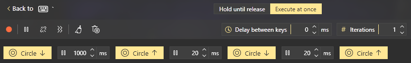

    So, if the "correct amount of power" is constant, you should use this [Combo] on [Single Press] activator:
    Click image for larger version  Name:	Screenshot 2023-03-19 005026.png Views:	0 Size:	20.2 KB ID:	236143

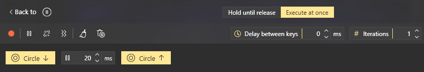

    Otherwise, you would need only the last three nodes of this [Combo] remapped to the [Release Press] activator.
    Note: adjust the first pause to the time the button must be held for a perfect shot. 2nd and 3rd pauses should be increased if your game runs under 50 fps.
      Hi shion, Well i hold the button for power, the longer i hold it the more power i get, i need to control this.. what i need it to do is when i have let go of circle , after holding it, for it to automaticly press circle again
        As I have already mentioned, set this [Combo] to [Release Press] activator and increase the pause value in the middle if your game runs at under 50 fps:
          Works perfectly , Thankyou Shion. Much appreciated.
            You're welcome!
