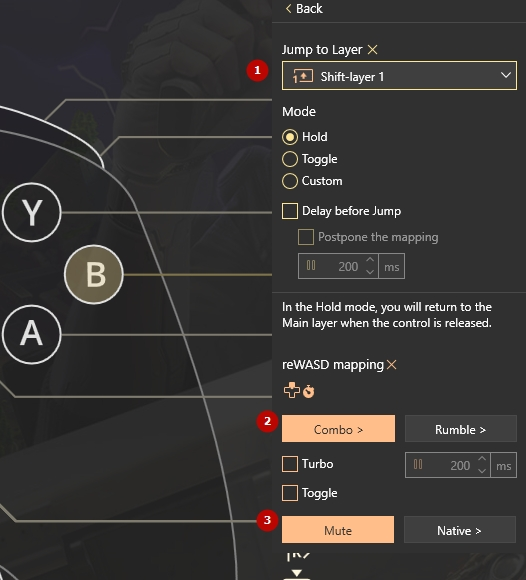

            Here is an example of such a mapping:

            When the combo has played, and I release the B button, I don't get B button input.​
