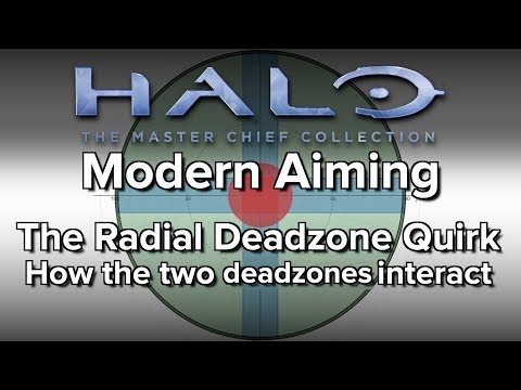

      Here is a great video showing the axial deadzones in Halo: Combat Evolved in a great manner with some onscreen representations:
      Another excellent video talking about axial deadzones and radial deadzones (radial ones are the "normal" deadzones that reWASD can do something about):
      As for games pretty much the ones I already mentioned like Remedy's CONTROL, the new RoboCop: Rogue City has some nasty axial deadzones where diagonal movement is heavily affected, and Halo: Infinite has menu options for defining the intensity of the axial deadzones, and it's free to play on Steam (multiplayer portion is but the settings are there too) so that is an easy game to test with.

      Axial deadzone = the amount of input required along the X and Y axis before diagonal input is detected. The higher the value, the more your joystick movement will be computed as staying on a straight line when aiming in a linear fashion horizontally or vertically. Picture a cross on your joystick. Lower values will feel more twitchy while higher values will feel more stable. This setting also prevents drift as it creates an additional center deadzone.​​​​​​​
        Like I mentioned, the purpose of the axial deadzone is so that any movement within the cross-shaped blue area will register in the game as left/right/up/down, however when the blue area (the axial deadzone) is TOO BIG it prevents fine diagonal movement. Halo: Infinite's axial deadzone options reduces the size of the cross-shaped blue areas (the axial deadzones), or enlarges them if you want.
