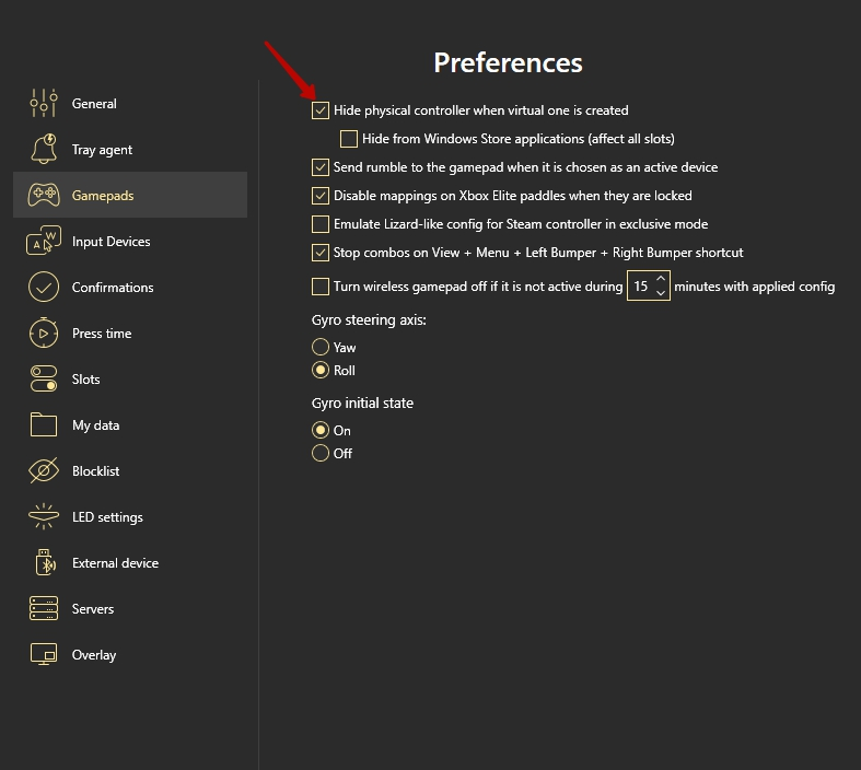

    Hello. Your case is quite specific, so I would suggest you the following workaround in case you are remapping your externally connected controller via reWASD:
    Group your built-in and connected controller in reWASD.
    Then make sure this option is enabled in reWASD Preferences:

    And apply the config to your newly created group.
    Thus, reWASD should hide 2 physical controllers in the system and instead of them, one virtual reWASD controller will appear.
    Hope this helps.​

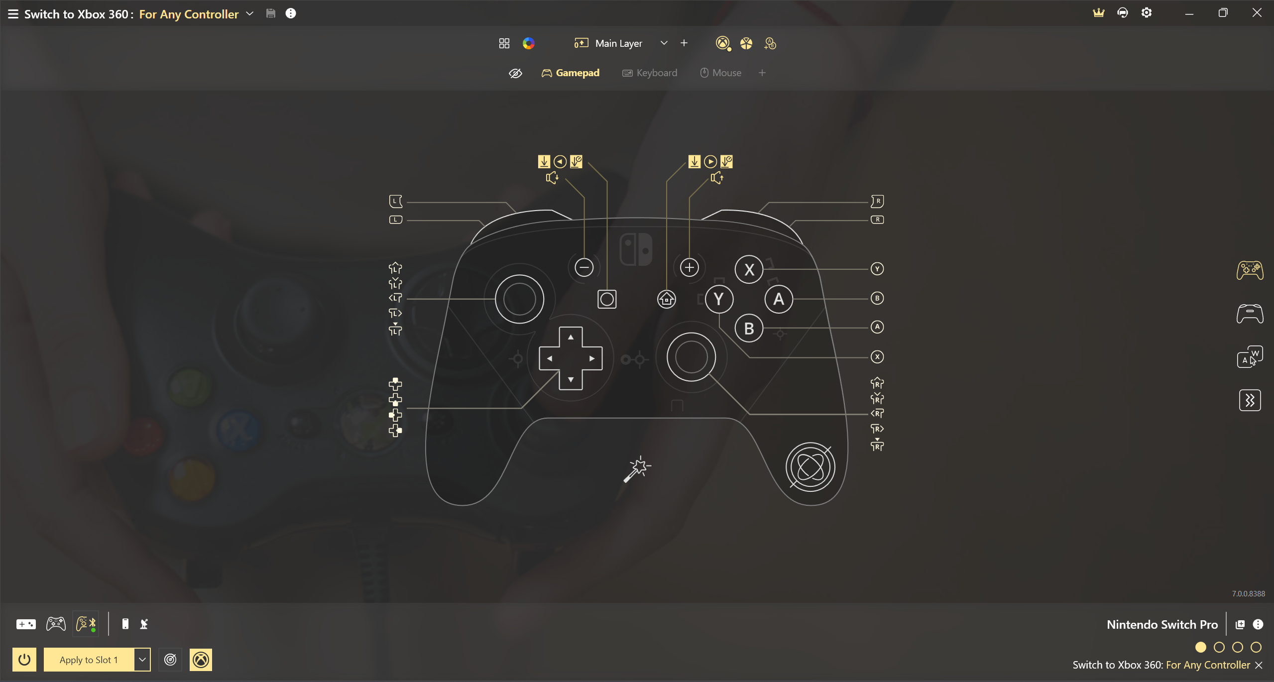

              1. Please send a screenshot of the full reWASD window with your config on it.
              2. Check if our virtual controller works in the tester.​

                Both Physic & Virtual work with gamepad test, only happened in game such as Diablo 4, God of War. The way I can make it work like I said, Disable/Disconnect both first, and reconnect which one that I want to play game. I still can enable the 2nd one later to make it work both outside of game. Just the game only recognized which one is connected first (even before the game started), so I think it's related to which one is primary controller and game only recognize primary controller. That's why I request a function to specify which one is Primary Controller by Disable all controller, renable Primary one & renable all other controller back after Primary one enabled.
