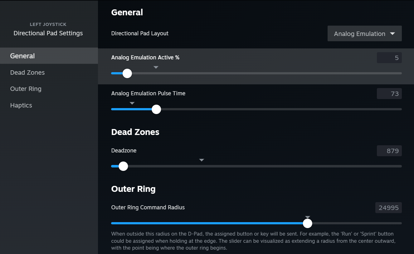

      As it turns out Steam input actually have implemented this feature:
      And it actually works really well in games that respond well to micro key-taps, So you can take que from this. We already have inner/outer deadzone control in ReWASD as well as ability to assign extra key for outer region (for instance adding shift for sprint at full deflection), so all that's needed is those two sliders to tune timings/intervals of keytaps
