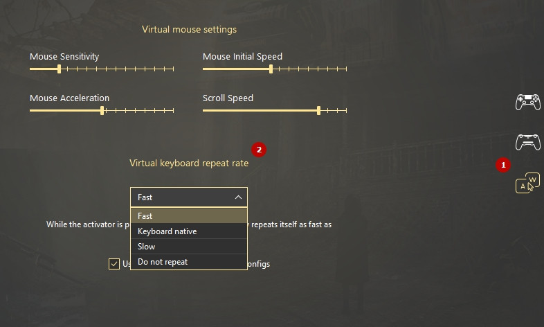

                            We have released new reWASD version that allows you to adjust the repeat rate for the virtual keyboard.
                            The default one is set to Fast — the same that it was previously. However, you can change it to "keyboard native" (it will be pretty the same as the keyboard acts), "slow" (twice slower than an physical keyboard) or switch the repeats off. The last option will be the best for APEX according to our tests.

                            Would be happy if you try the new version in action!
                              Thanks a lot for adding the repeat rate options.
                              Can we get more granular control of this option? (The Virtual keyboard repeat rate)
                              For the moment, I have the option of:
                              - "Keyboard native", which is super fast on my system, I don't know why. I even tried to set the repeat rate in "Windows/Run/control keyboard" to the minimum, and it doesn't seem to affect the reWASD speed at all, only my hardware keyboards.
                              - "Fast" seems the same as "Keyboard native" for me.
                              - "Slow" is half as fast, but steal very fast.
                              Can't this be a slider? The slider's start should be repeat rate 0 (Do not repeat) and the end should be what Fast is now (or faster, if you want, just give me control of the steps in between). Or even a number input field would be better than the current solution.
