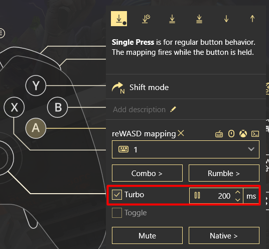

        In reWASD, you can add a turbo and the frequency of its pressing for each button separately.
        We added the speed settings for the stick remapped to arrows to the to-do list. Thanks for the suggestion.
          Click image for larger version  Name:	Screenshot_1.png Views:	0 Size:	103.7 KB ID:	232836
