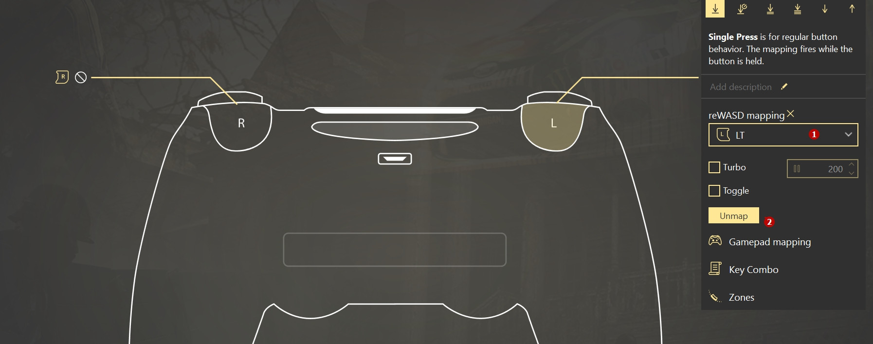

    You are using the DS3 and a virtual controller in reWASD, right? In this case, you need to add "Unmap" for each button you use for your Shortcut. Please follow the steps:
    1. Map RT, LT and X to the corresponded buttons of Xbox 360 controller using reWASD mapping drop-down list
    2. Click Unmap for triggers and choose Unmapped option in Gamepad mapping section for Cross:

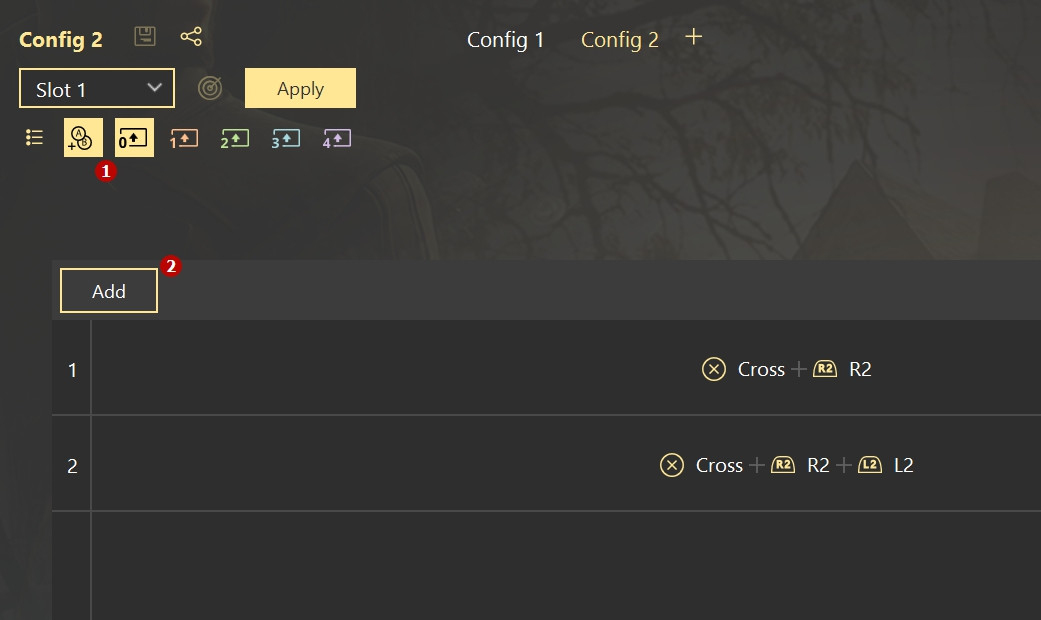

    3. In the Shortcuts section (1), Add (2) the combination you need and assign the required combos:

    4. Press Apply button and agree to hide the physical controller.
    I hope it will help.
