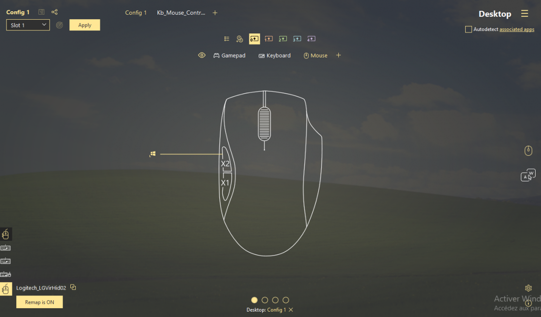

      Well here the two setup i tried :Click image for larger version

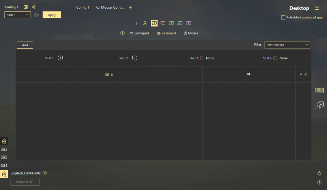

ID:	217087However thanks to your screen i might have found the issue, on the screen below you'll see the controler devise list which is at the bottom left cornor of REwasd, and both of the screen i sent earlier there's still this "Logitech_LGVirHid02 which isn't my mouse or either my keyboard and it's stuck on it, maybe it's a driver or software issue i've indeed a logitech software for my mouse G502, and my keyboard is just a regular keyboard, i don't see why there's like 4 device on the list while i just own 2 device : Keyboard and Mouse
ID:	217090here's the said last screen
          I have no fast explanation why you see Logitech_LGVirHid02 as a separate device but it seems that it is not the one you need.

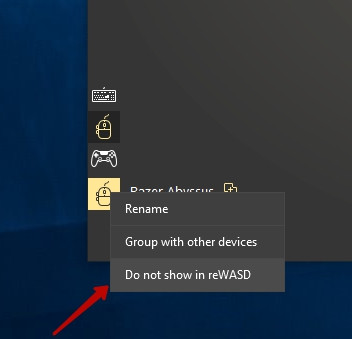

          Right now, I advise you to black-list it as far as it has no use. Right-click the yellow icon and choose Do not show in reWASD option. You will need to confirm your choice in the pop-up window too.
          Click image for larger version  Name:	620778001e.jpg Views:	0 Size:	14.5 KB ID:	217092
          You will switch to the next device in the list. I may assume that the one you have above the mysterious mouse (with keyboard and mouse icon) is your physical mouse. It has additional buttons and so they are detected as a keyboard inside a mouse. Once you choose this device (you need to click on it), you will be able to Apply config to it.
          You will need to switch between all devices in the list and black-list the ones that should not be there.
