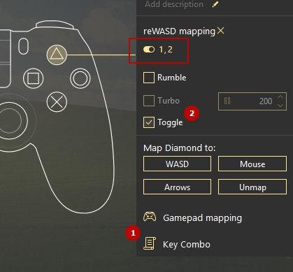

    You are right, you need Toggle and Combo used together.
    First, create a combination you want to loop using a Combo Editor.
    Second, check Toggle option.
    In this case, not the mapping but a combo will repeat itself while you press the button again.
    Please choose Execute at once mode to enable Toggle.
    If you need something else to be toggled, specify the exact macro sequence so I will try to suggest better steps.
    Click image for larger version  Name:	0fb5df6a08.jpg Views:	0 Size:	34.2 KB ID:	217242
