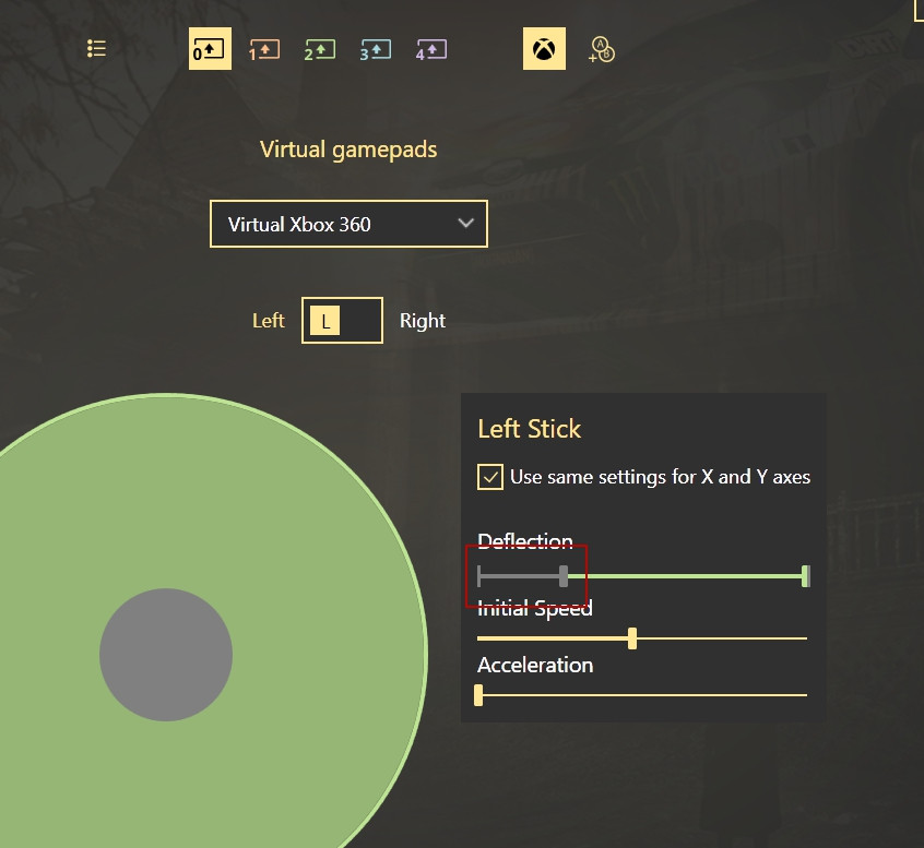

        First, I don't think you need to use a combo for WASD to Stick. The ordinary mapping will work better. It was re-worked in the latest version too and now simulates the analog behavior even on a digital key. In order to make stick more responsive, I've also increased the Initial Deflection — the starting deflection of a stick that is emulated when you slightly touch the button:

        In case you feel that stick moves to fast or too slow, please tune those virtual stick settings that are shown on the screenshot above.
