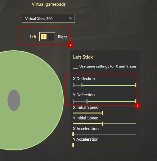

                I already have that unchecked, how do i change the deflection separately all i see and is left and right stick is that different?
                  Once the option is unchecked, there are two sliders for X and Y axes (1). Also, you can switch from Left to Right (2) to tune both sticks:
