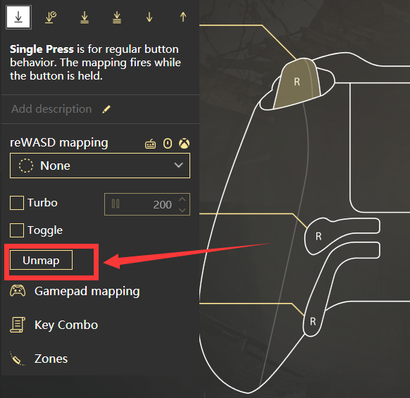

          as shown in the pic, the RT's unmap is off.
          In the older version, when I press RT, it act with no delay,even if I setup a 7 in [Long Press]
          and when I upgrade to new version, it has a delay.
          as you said, the single press waits about 300ms for long press, but it should be with unmap? but my unmap is off.
