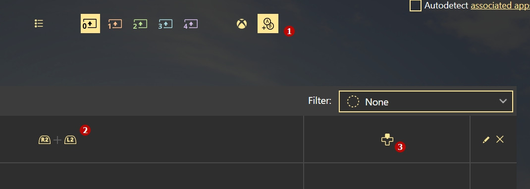

        The way I understand is that shortcuts allows me to simplify the inputs.
        Shortcuts do the opposite thing: they allow you to choose up to 4 buttons (that should be pressed together) and map them to a single action. Seems they are perfect for the thing you mentioned in the end of your previous post. On the screenshot below, I've entered Shortcuts (1), added a shortcut that consists of two triggers (2) and mapped D-Pad Up to them (3). In your case, you will need to map some keyboard key that works as a toggle for a super mode:

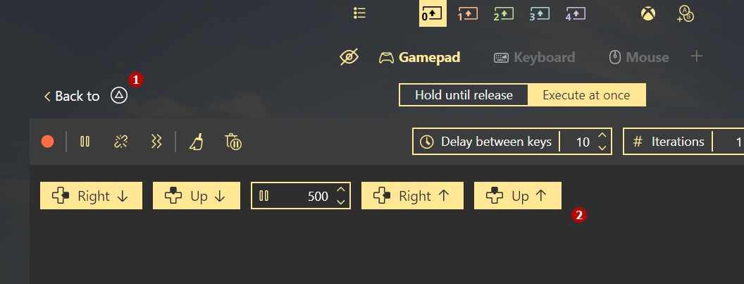

        Getting back to the several buttons pressed by a one, you need Key Combo in this case. Here is a fast example. With this one, when I press Triangle (1), I got D-Pad Up and D-Pad Right pressed together during 500 ms (2):
        There are two guides about combo we have: the one on the main site with use cases and the one from help guide with the detailed description of all controls. Combo Editor has a lot of potential so will be waiting for more questions :satisfied:
