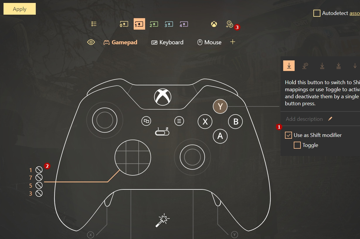

    Y should be a Shift modifier. Inside this Shift, you need to put "Unmap" for all four D-Pad buttons and add your ones: 1, 3, 5, 7 + Shortcuts.
    Unfortunately, right now, all those mappings will fire without the delay.
    Here is how it should look like (1. Shift modifier; 2. Unmapped D-Pad with your keyboard actions; 3. Shortcuts set inside the Shift too):

      Thanks! Your advice to unmap the d-pad for the Shift profile was exactly what I was trying to do!
