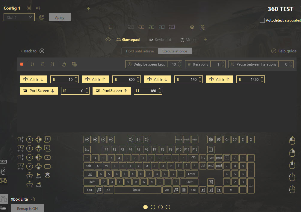

                Yes, set stick movements in a combo. It should be looking like this
                Try this sequence in the game. So, you plug the controller, the select button you want to assign a combo, add combo and hit apply button. Check in the game. You also can adjust pause between keys (delay between keys option), try less if you need to trigger the combo pretty fast.
                  Thank you but how were you able to record controller stick movements? I hit the record button and moved my stick around but it doesn't pick up the movements. It only picks up buttons I press on my controller or push down on the sticks

                    I attached config (the combo assign to D-pad down). Please download the config and import it. You may copy the combo and assign it to the required button of your config. There is no option to record sticks movements for now, only digital buttons.
                      Thank you. I downloaded and it works when I press the down button on D-pad but anyway to adjust the speed? more faster cause it moves the camera 360
                        Try to lessen the delay between keys. I set 120ms, try to fiddle with 20-40 ms delay. Unfortunately, I don't have chances to test it on my own, so let us know how it goes.
