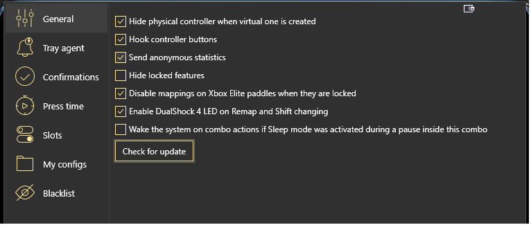

    May I ask you to check this option in the reWASD settings. This option hides the physical controller when virtual creates. Therefore, the problem could be that there are 2 controllers, physical and virtual, the game detects physical only.
    Thank you in advance.
      Thank you for your report.
      Yeah got that one checked by default
        This is how it looks right now

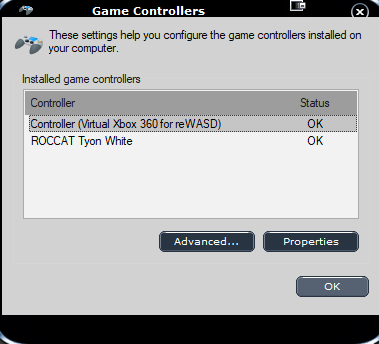

            Please, send us the config you are using to play Fortnite - https://prnt.sc/r8gwtc. Do you use a controller to play or keyboard\mouse for remote play? May I ask you to apply the config, open joy.cpl (win button - > type joy.cpl) and take the screenshot. How many devices are there?
            ps. You may edit your posts without pre-moderation now.
              Allright here is the screen shot and the config and I play with xbox elite controller v2
              Click image for larger version  Name:	Naamloos.png Views:	0 Size:	20.7 KB ID:	218371

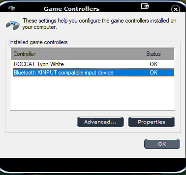

                            Thank you for your information. Going to test the reWASD with the 2004 Insider Preview. There is kinda hunch that virtual gamepad is not hidden properly. Also, I would like to ask to do the following steps:
                            1. Open the reWASD and apply the config you have been applying before.
                            2. Open joy.cpl and how the controller is detected. Important to see whether it detects as BT XINPUT compatible device or as a virtual controller for Xbox 360 after the config applied. Take the screenshot.
                            Thank in advance.
                              After I open Rewasd I have to click the controller with the blurtooth sign then my profile pops up and I get this
