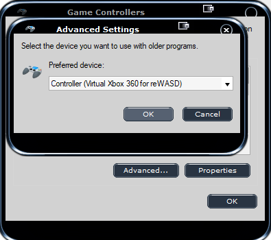

        Wait at joy.cpl you have advanced it was set to use older games with roccat mouse I changed it to virtual xbox 360 and now my mappings work in Fortnite is this maybe the culprid ?

            • #21
              Ps as of now it is working how it should work thx for pointing me to the right direction

                          • #28
                            I fixed it again went to joy.cpl and default was set back to none changed it back to the Xbox virtual and now it's doing fine again thx for the help
