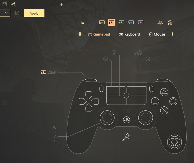

        Thanks for the detailed message, sure, Shift layouts are a great addition to the config, we agree
        Still it seems that you do not need to remap Stick to WASD inside the Shift, because in this Shift it works the same way as in Main.
        I mean, you need to see the following in reWASD:
        In this case, whenever you enter the Shift or go back, nothing changes on your stick.
        Could you please test it?
        Basically, if some control inside Shift should do the same as in Main, you do not need to duplicate it inside the Shift, it will be inherited automatically.
          Your idea about "selective" Unmap is pretty interesting, but at the moment, it is hard to understand whether it is possible to do.
          We will definitely take it into account.
          However, if my suggestion above works, seems you won't need it and Xpadder at all.
            Wow! You are absolutely correct!
            That resolved my issue!
            I didn't realize you don't need to duplicate the button layout in Shift Mode for the same buttons as the main config.
            It automatically uses the same setup as the main config unless you change it manually. I understand now.
