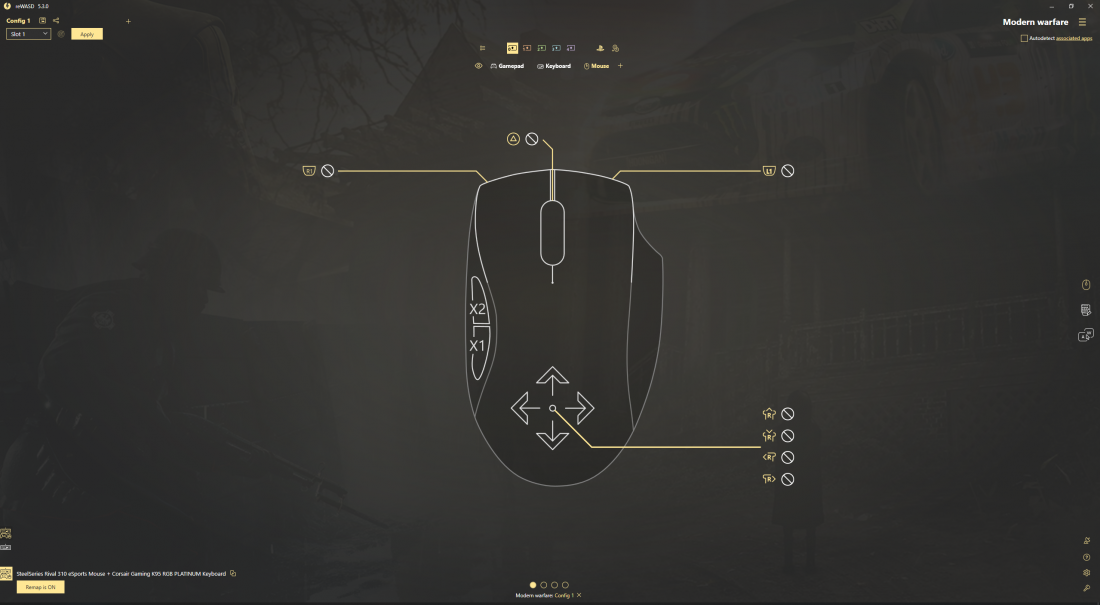

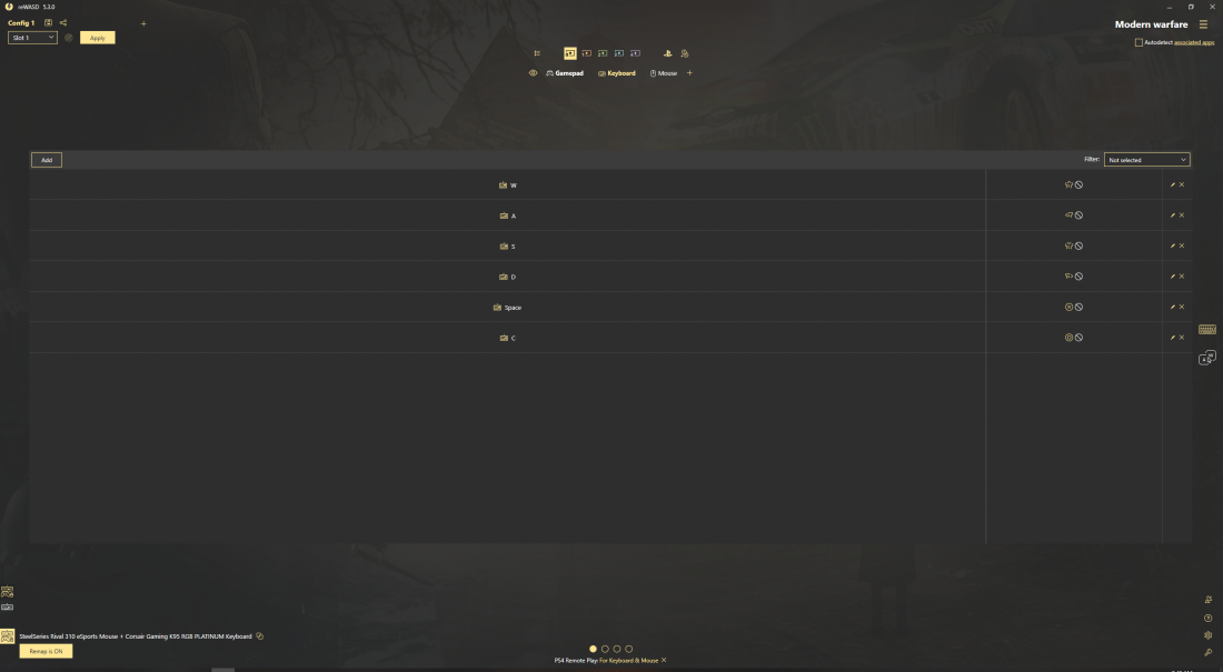

      So basically, my goal is to emulate an xbox/ps4 controller on pc without actually using a controller.
      What I did was:
      1. Group kb and mouse together after making sure they're the correct device after checking with detect device.
      2. Create a new profile and in the kb+m section, map all the controller keys to the keyboard and mouse keys with the unbind setting

ID:	218691I didn't touch the gamepad section because I'm not using the gamepad to make kb+m commands.
      when I do this, the wireless device does appear in joy.cpl, but the game still doesn't detect the virtual controller even after restarting.
      I also don't understand why when I select the xbox 360 virtual controller instead of the ps4 one, I still don't see the "virtual 360 for reWASD" in devices list.
        Also something I've noticed is that when I apply the profile and the software warns me that I will lose control of my mouse when I will apply the profile,
        I still have control over the mouse, so maybe that's part of the problem?

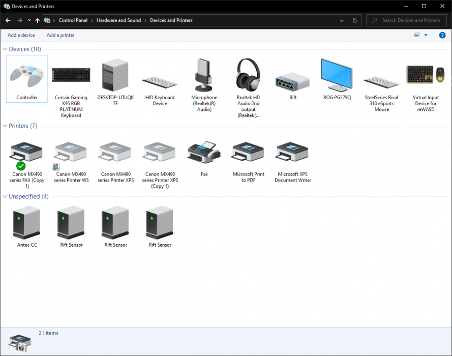

                              The virtual input device is the virtual keyboard that reWASD creates to emulate your keyboard. If you open devices and printers you will also see the virtual input device for the reWASD (screenshot).
                              So, the joy.cpl registers the emulated physical device correctly. The virtual input device is for another purpose device.
