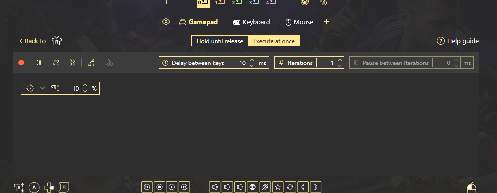

    The Unmaps feature activation is available from the mapping adjustment screen. Please feel free to check this article.
    It is not unbinding from the in-game key binds. Unmaps feature disables the native input of the keyboard or mouse, but the one you have mapped to it (virtual gamepad's stick) will still work. Feel free to try.
    Probably the reason slow walk does not work because the keyboard input comes 1st, and the game refuses to read the input from the virtual controller. The Unmaps feature should help in that case.
    You can also try adjusting the deflection in the Key Combo for the needed key, as on a screenshot (just use Hold Until Release mode). Yes, it should contain one button only

      I've tried everything as you said
      Sadly I still can't get my character to move in game.
      He moves fine but as soon as I press F3 (my switch key to activate slow mode) the W or S don't respond anymore in game. :/
