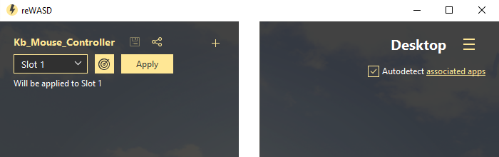

          From what I can see now, you have chosen an app to be associated with, but haven't adjusted which config should be applied. Please click "Radar" icon at the upper left corner of the main window:

          Also, a few more suggestions:
          1. Check the help guide about Autodetect
          2. Update reWASD, it seems that you are using an old version. It is better to use the latest ones, because with each release we do not only add new features, but also fix and optimize things.
            Thank you for your reply, but I don't see that the radar icon is enabled on your video.
            Please check the steps - https://recordit.co/KuQHPao4Ti. You need to add required exe file(s) for the game, check the "Autodetect" option, select the slot where config will be applied and check press radar icon. As you see, the selected config will be added Slot 1 as soon the app will be in focus.
