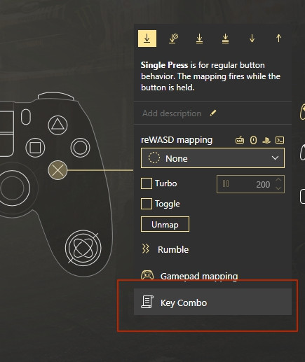

  • reWASDer
    replied
    I think, you need to use Combo to do this.
    1. Choose your controller button and press Key Combo:
    Click image for larger version  Name:	8b56df6225.jpg Views:	0 Size:	46.4 KB ID:	218980

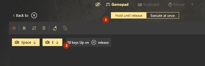

    2. Switch to Hold until release mode (1) and add Space and E (2):
    Click image for larger version  Name:	5cb791aa31.jpg Views:	0 Size:	23.1 KB ID:	218981
    3. Press Apply and try it in the game.
