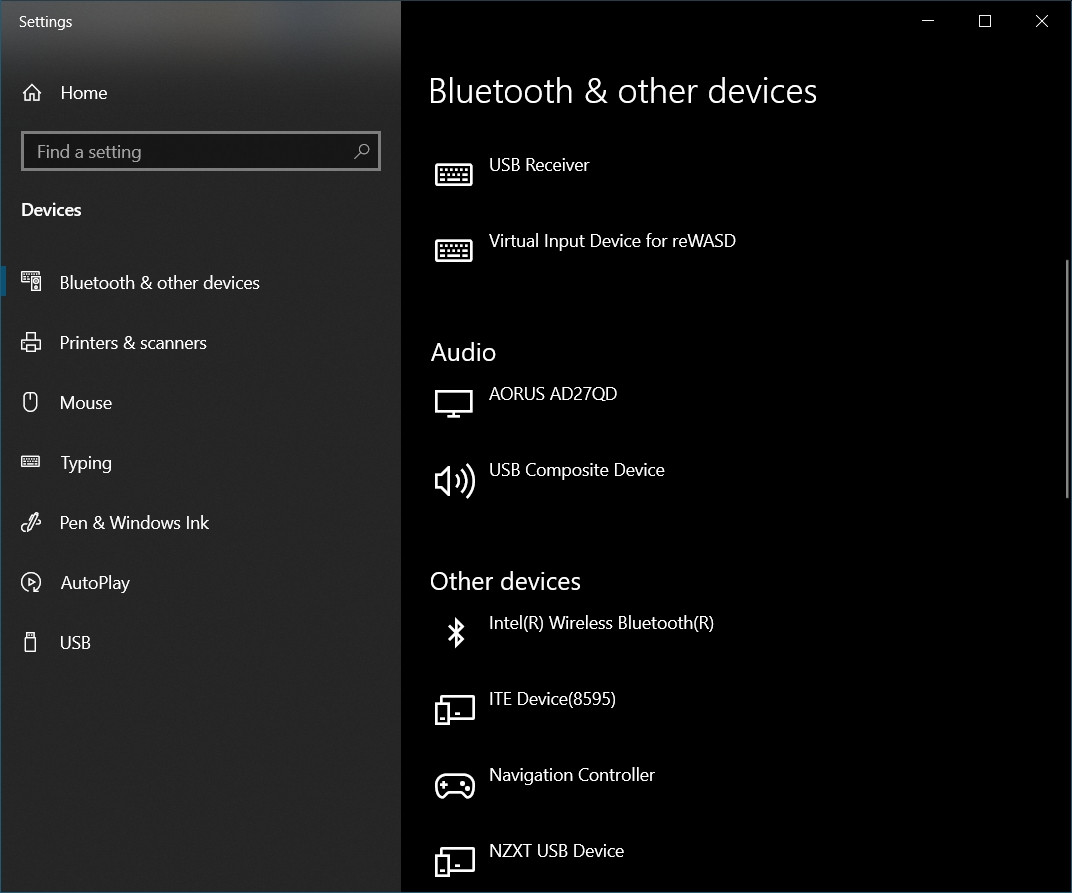

      There ya go.
      I can see it on Rewasd and bluetooth menus but as soon as I unplug the cable, it's gone.
      Can you guys add a force re-pair button/bring the first start/pair as an option to the menu? It's no longer there after hitting "Pair" first time. Maybe it would help with future testing/trying to pair again via bluetooth.
      No third party bluetooth. Anything you guys are using? I can buy one but will take some time due to current situation worldwide.

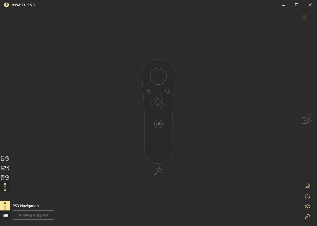

                  Hello! Just asking if two years later you somehow managed to add a pairing button somewhere in the menu? I connected the PS3 Navigation controller, but before I could click on "Pair" the dialog vanished. I tried to reconnect, but the dialog stayed hidden. I can use the controller wired, but that's not feasible. The whole point of that controller is to have more freedom of movement. What I tried so far:
                  1. https://help.rewasd.com/how-to-remap...vices.html#ps3 suggested to clear data in the settings menu. I did that, and my set up controller profile is gone. Yet the pairing screen does not come back.
                  2. I tried to remove REWASD completely, rebooted, installed again, rebooted. Yet the pairing screen does not come back
                  3. I tried the "reset" button on the back of the Navigation Controller,
                  Hardware info: OS=Win 10(22H2), BT-dongle is an ASUS USB-BT500 (https://www.asus.com/de/networking-i...ies/usb-bt500/).
