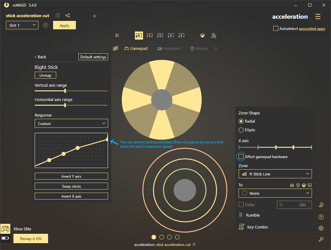

                  You can remove stick acceleration (from any game) by using a trick - lower the stick's maximum speed. The size of the lowering must be adapted to the specific game.
                  If speed does not affect the game, you must additionally select the option - Affect Gamepad Hardware
                    Click image for larger version  Name:	stickacceleration.jpg Views:	15 Size:	157.8 KB ID:	219616
                    Doesn't cutting acceleration like that only work if you don't reach that deflection?

                      The trick Nirpo suggested works for physical sticks, not for a mouse mapped to a stick.
