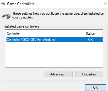

              Sorry, so this is the device when Remap is off:

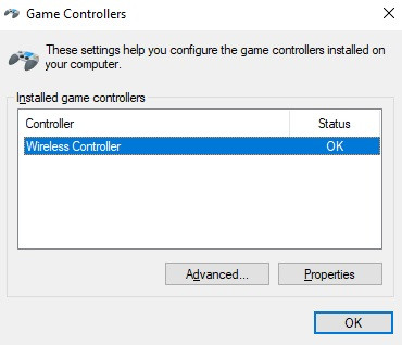

              This is the device when Remap is on:

              ​If Remap successfully turns off it reverts to the first image.
              When it doesn't it stays like the second image. When this happens no software action, service termination, or uninstall, including unplugging and plugging the physical controller, will change the entry. This is the case where it will hang on system shutdown if I try to turn off my PC via the Start menu. Only restarting the computer by holding down the power button will fix it and then it goes back to being the first image.
