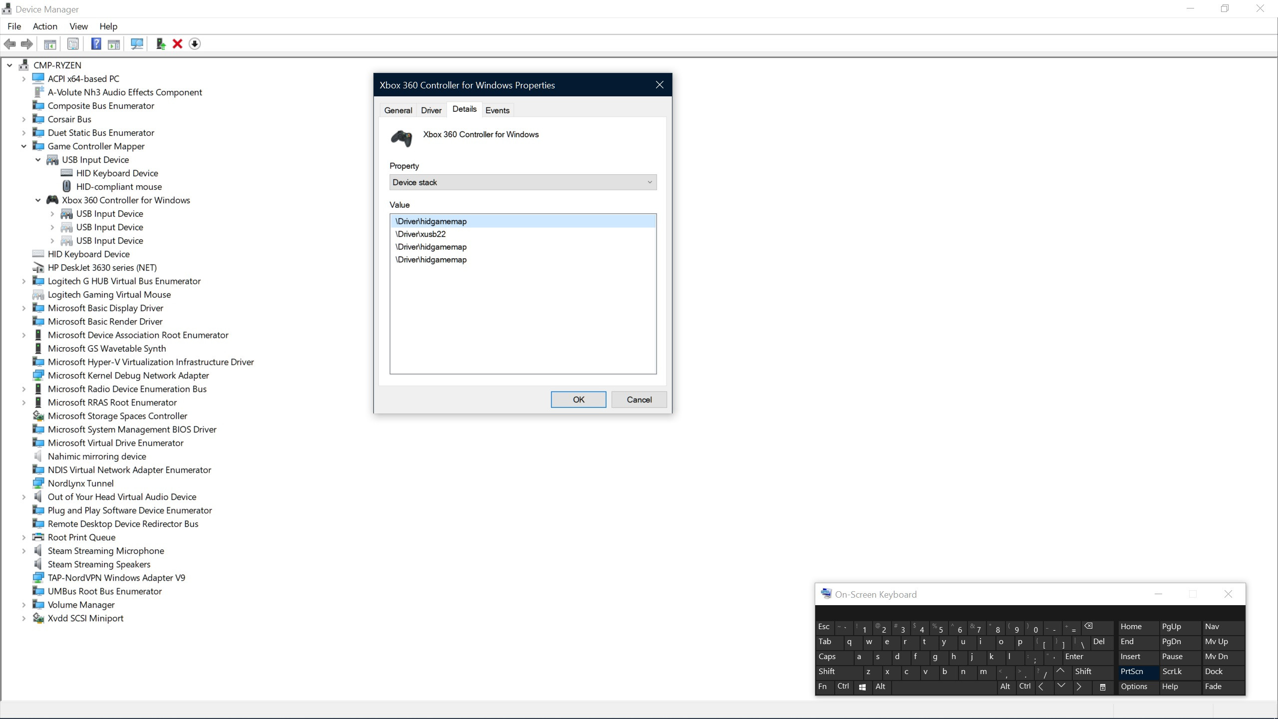

        Thank you for logs. It looks like the virtual controller is still in the system. We send system command to remove the virtual controller, it's removed from the physical bus but still handled in the system for some reasons. Perhaps some other driver or process. I made a video explaining how to check the driver stack of the Xbox virtual controller - https://streamable.com/i7bdxn. May I ask you to follow these steps to take the screenshot of the device stack. The footage contains steps of physical device connection, virtual controller creating, and check device stack.

        • #19
          Hi, here is the screenshot of the driver stack.
          Cheers
          • #20
            Great! Thank you for your feedback. Seems that the stack driver is correct. We will investigate this case more detailed and but to you with updates.
