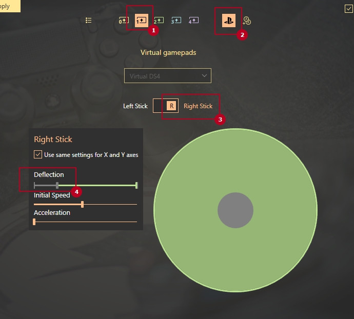

            In your case, the game changes the sensitivity, because you change to the aiming mode. You need Shift to compensate it.
            Use your right-mouse button as a Shift modifier in some new Shift, and change the Initial Deflection (set a bigger grey zone):

              If i put the same settings than for Switch 0 it will work?
                How can i copy/paste the advanced mouse settings from Switch 0 to Switch 1 ?
                  Nope, you need to add other settings. You have the same settings at the moment, but the game changes the stick behavior while you aim. Mostly, the games make stick a bit slower. So, you need to add a bigger Initial Deflection or add a bit of sensitivity. Also, you may try to tune in-game settings (the ones dedicated to controller, aiming part).
