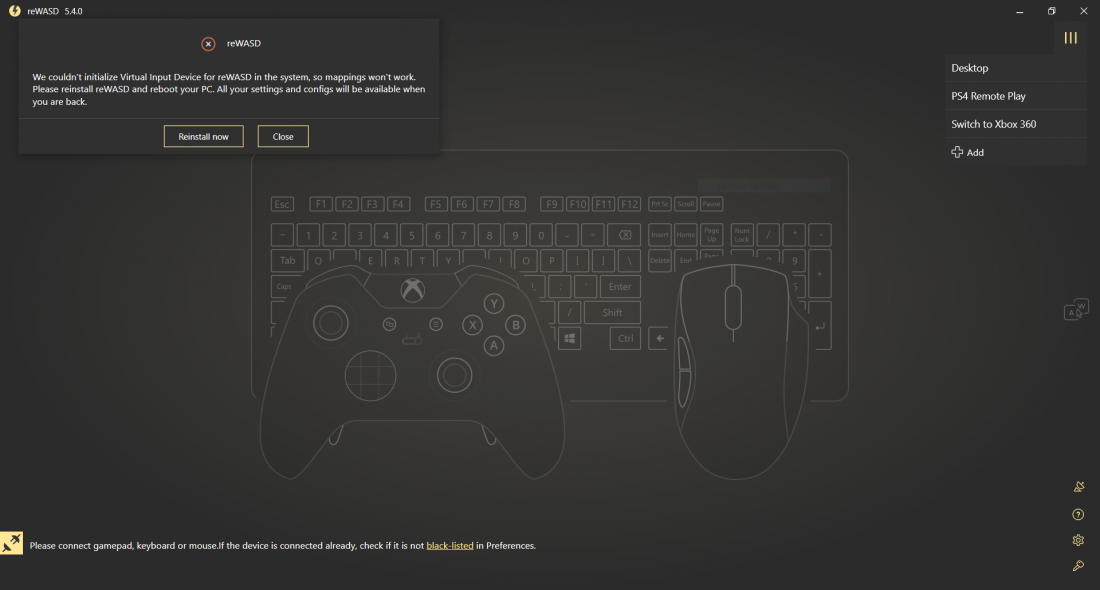

    I have a problem when I launch ReWasd. I've got this screen that pops up at launch :
    When I click on "reinstall now" nothing happens. I try to reinstall from scratch but without success.
    I also try to desactivate my antivirus software but I still have the problem.
    What's surprising is that I've already used the software for 1 month without any problem, but since I did a windows update yesterday (I don't know if it can be related) I can't get rid of this problem.
    Does anyone know how to fix it please ?
    Thank you in advance for your reply and have a nice day!

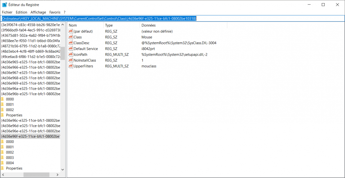

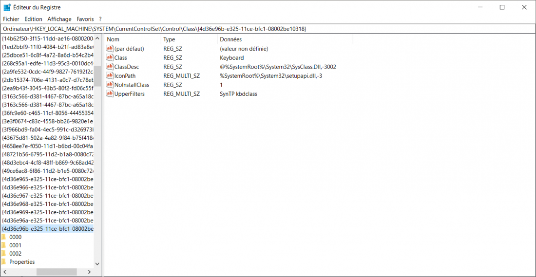

    Please open the registry editor (win+R - > type regedit) and check the following registry threads:
    1. HKEY_LOCAL_MACHINE\SYSTEM\CurrentControlSet\Contro l\Class\{4d36e96b-e325-11ce-bfc1-08002be10318}
    2. Computer\HKEY_LOCAL_MACHINE\SYSTEM\CurrentControlS et\Control\Class\{4d36e96f-e325-11ce-bfc1-08002be10318}
    Take the screenshot of both of them. We need to see the UpperFilter value. You may copy/paste threads in the registry search line on the top.

      Thank you for your answer. Here are the two screenshots.
      I made yesterday the update to Windows 10 version 2004 (I was on version 1910).
        Thank you for the screenshots. It helped understand the problem.

                The reason why reWASD doesn't run properly is that our driver was wiped out by another one - SynTP - Synaptic touchpad driver which is part of Lenovo software - https://prnt.sc/t6rvj4. So, our driver is re-wiped every reboot after software installation which causes this error message. Perhaps it's due to the latest Windows update and incompatibility with the current version of Lenovo software or unsuccessful Windows update itself.
                I might assume that Windows re-installing will fix the issue. It always fixes everything.
