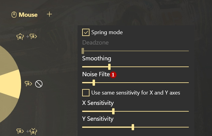

      Thank you much! I figured it out... I grouped them and used shift. Is there a particular template i should be following for the mouse emulation settings in order to remove stutter or the feeling of skipping pixels? I have adjusted multiple settings to where it feels ok, but as you guys have more experience i figure you know more about what should be what than i do for optimal settings. I've searched youtube but to no avail.
        Unfortunately, it's too personal.
        Please review this video: https://www.youtube.com/watch?v=KtBHArN3QW0
        In case you feel that mouse moves, but the virtual controller is not, you may need to tune the Noise Filter:
