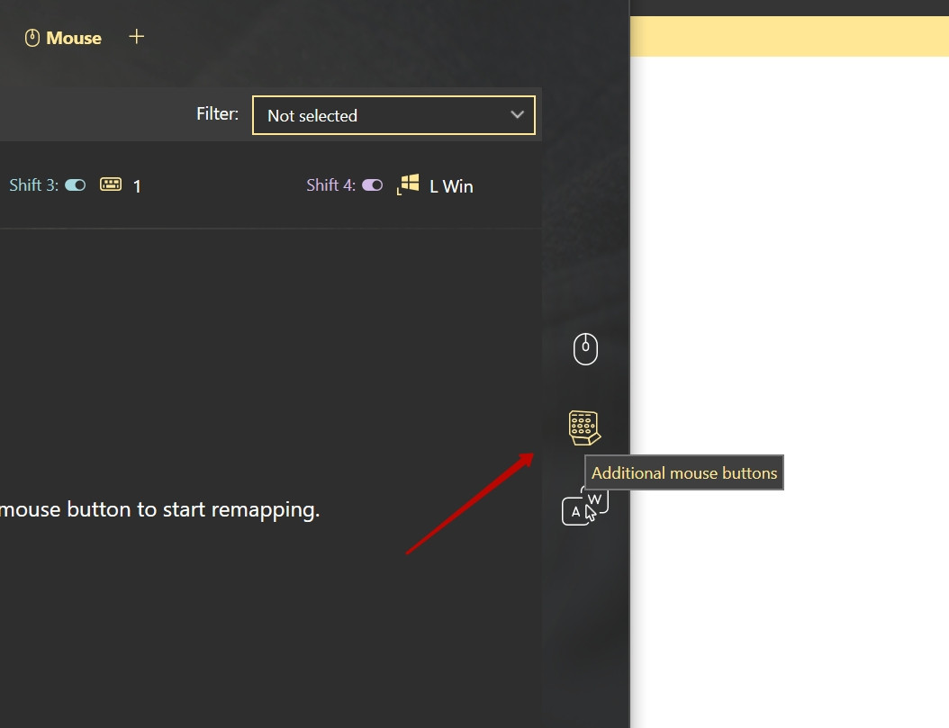

    That is not a problem. You need to associated this device as a mouse. Then, you add mouse mappings as usual and add keyboard mappings to Additional mouse button section.
    Click image for larger version  Name:	418877f517.jpg Views:	1250 Size:	60.7 KB ID:	220461
