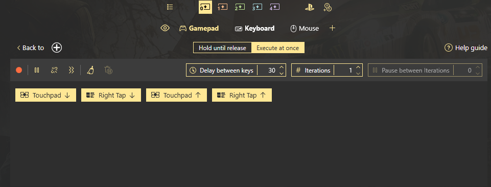

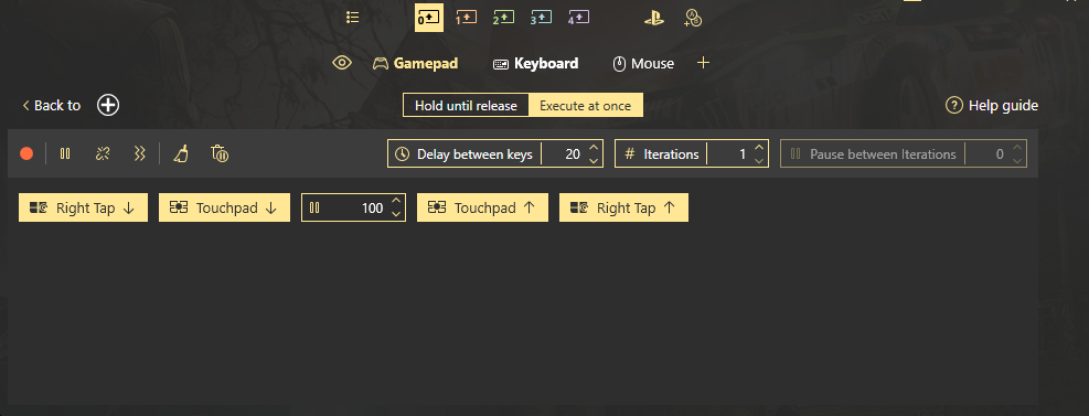

                    Here is what I've tried:
                    The configuration in the last 2 images are the ones I got working before I deleted the keyboard configs and it stopped working. Note I have also tried using the unmap function as well as mapping these inputs to individual buttons and pressing them at the same time.
