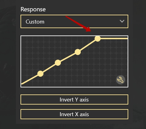

    At the moment, I suggest you to do the following. In the config, go to Advanced stick settings and set a bit different Response curve:

    With this one, the stick will be deflected to 100% when it sends 85% only.
    Sorry, I've made a screenshot using the new unreleased version, so you may see a small teaser of a new feature we are going to add there
      Thanks! I could have sworn I tried that first but it definitely worked this time.
        Yay! Great :satisfied:
