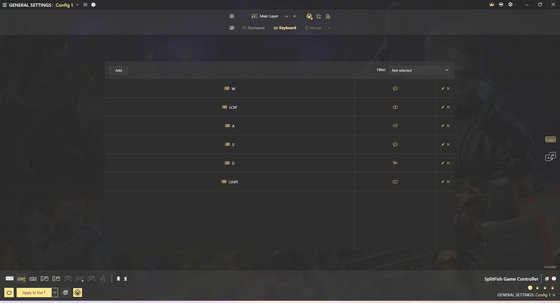

            So i put it back in keyboard mode and it seems reWASD saw it and said it is active , but the blue light on the fragchuck dongle is not lit, this is what reWASD screen looks like after i tried to map some buttons in keyboard mode.

                You mentioned that "reWASD shows Fragchuck as disconnected", although on your screenshot, the "SplitFish Game Controller" keyboard is shown as connected with remapping enabled for it. So remap should be working as intended in this situation. You can test this on [Gamepad Tester] site once you apply the config.
                However, it seems that you are remapping that device only, even though this config is meant for a group of a mouse and keyboard.
                If our virtual controller does not work in the game - disconnect all other controllers from your PC and apply the config before starting the game or its launcher.
