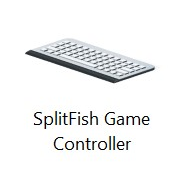

The controller uses a wireless dongle that plugs into the PC, and has a physical switch between two modes - "Keyboard mode", which assigns pre-determined keyboard keys to each of the buttons to save remapping (WASD for LS movement, V for LS Click, LCtrl for LT etc.), and also has a "Gamepad mode" which sends the controller inputs as xInput (or similar) which can be remapped to keyboard keys via software.

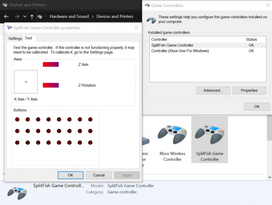

With ReWASD installed, I checked the controller in Devices and Printers. When using Windows's built-in calibration menu, the controller doesn't respond to stick movement or button clicks. AntiMicro, that worked perfectly up until installation of ReWASD, doesn't respond to input. As a test, I temporarily uninstalled ReWASD, kept the FragChuck in "Gamepad mode" and restarted the PC - all "Gamepad mode" functionality on the FragChuck returned to normal. Windows and AntiMicro both saw the controller inputs again. So I'm confident that this is an issue with something within ReWASD that is blocking "Gamepad" inputs from this particular device. Xbox One controllers are unaffected, so I'm not sure what would be different here.
