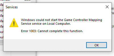

    I am sorry you have faced with such difficulties. When you got the Error: -1 message, please open Services, find the gamepad controller mapping service, and right mouse click and check if the service us running (screenshot). Please run it manually if it's stopped. Are there any error messages popping up after manually starting? Please take the screenshot of them.

        As of now, reWASD does nothing when I choose to start the game pad service, starting this is usually when it starts up, stalls then gives me Error: -1, but now it's simply freezing up. It does not generate a zipped log in the archive as of now. When I tried to manually start the game pad service in Services, it gave me this error.Click image for larger version

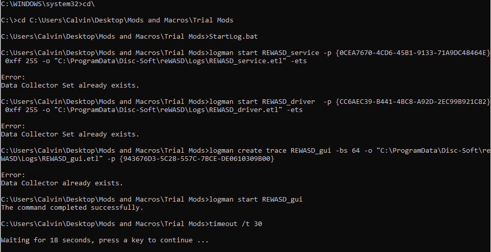

                I followed these instructions perfectly. It seems that StartLog.bat starts some sort of countdown, but I went ahead and left the window open anyway and waited for it to produce error: -1, then ran StopLog.bat command. It produced no Logs in the folder.
                  It said "Error: Cannot create a file when that file already exists".
                    Here is the prompt for even more reference.

                      Please, try to use this archive for the logging. Steps to collect logs are the same.
