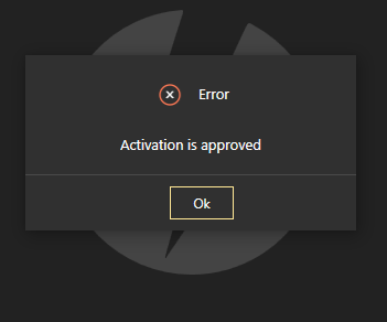

          • #20
            I've made progress in troubleshooting. reWASD seems to be opening properly now and able to access the WMI Repository after I've rebuilt it, but now it gives me a new error.
            ERROR: Activation is approved
            • #21
              Please, open the C:\ProgramData\Disc-Soft\reWASD directory and remove license.dat file. Try to open the reWASD again. Is the problem reproduced?
              If, so, what steps are to reproduce the problem?
              • #22
                I ran it as administrator shortly after my original unapproved post and that solved the issue. reWASD is running as intended and I am enjoying it, thank you for all of the help!
                • #23
                  Great news! Glad that the problem has been fixed. I wonder what was a troubleshooter, the license.dat removing or some permission if was fixed when the software was launched as Admin?

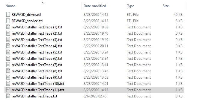

                            I noticed that the service tied to reWASD was named differently as shown in the screen shot. also, these are the files in the log folder. what is the right one? the text files just say,
                            reWASDInstaller: 14:13:41:062 TryCloseWaitDialog
                            reWASDInstaller: 14:13:41:063 Existing wait dialog count: 1
                            • #29

                                We need etl files. You have them, those ones at the top of the list.
                                Which service name do you see? Star-Lord sent you the way how it should be. Can you make a screenshot of the one you have?
