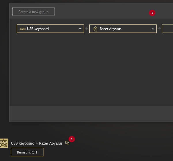

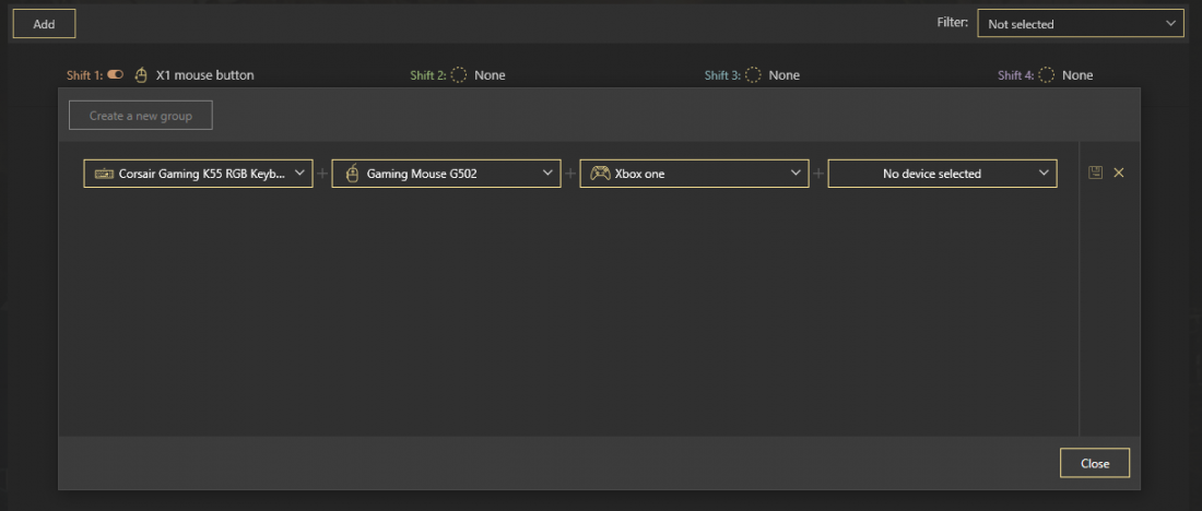

        Let's ensure that all your devices are detected and initialized properly.
        Please show me your group, like here:

            1. According to the screenshot, the Xbox One controller is added to the group too. Do you use the controller as well while playing with a remapped keyboard and mouse to the controller? Please, try to remove the controller from the group and use only remapped KMB.

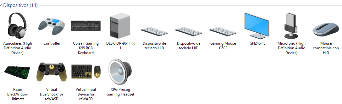

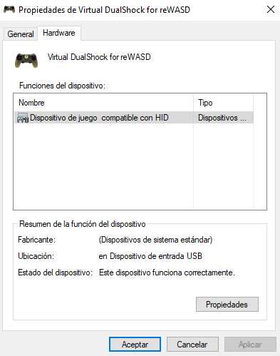

              there are the virtual controller that the app created
                1. Does the problem persist out of the game? May I ask you to try reproducing the problem without a game using joy.cpl or another gamepad tester, like https://gamepad-tester.com/.
