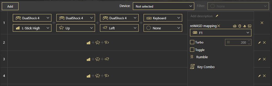

    I tried to achieve this result with REWASD but it does not allow me to map the Joystick Diagonals (i.e. Left + Up, Right + Up, etc) to a single keyboard button.
    Would you guys be able to modify the Joystick mapping so that when I press it in a diagonal (iLeft + Up, Right + Up, etc) it sends a single letter to the keyboard instead of a combination of 2 letters?
    - Maj D
    Hi there!
    You can archieve that with [Shortcuts].
    Select [L-Stick High] zone, [L-Stick Up] and [L-Stick Left] for up+left diagonal, map it to the key you want, and do the same for three other directions like this:
    Click image for larger version  Name:	Diagonal mappings.png Views:	1 Size:	30.7 KB ID:	221528
    [F1] is just an example. You might also want to add 4 other directions to the shortcuts ([L-High]+[L-Up], [L-Hight]+[L-Down], etc.), so they all will be in the same zone. That way you could use lower zones for something else. You can adjust zones in [Advanced] tab of a left stick.
      Thank you so much!!!
      That worked perfectly...
