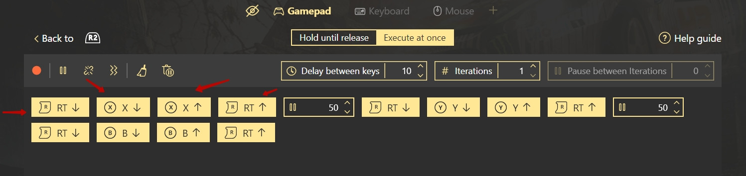

    Am I right, you want to press RT and get the following sequence: RT+X, RT+Y, RT+B ? If yes, it could be done with a combo:
    I am not sure if you need any pauses there, I've just added them as separators. Please pay attention to the sequences between pauses: in order two buttons to be pressed together, you need to re-arrange the positions of "presses" (arrow down) and releases (arrow up).
    In order to assign this combination to a trigger, choose the trigger from the back view and go to Key Combo section.

        Hm, tricky question
        You may achieve this behavior using combos (smaller ones, like RT+X only) + Shift mode, but in this case your trigger won't work as a trigger anymore. Do you use it as a trigger or is it just the think that works in a shortcut? Or maybe there are some in-game actions that require RT to be pressed and held?
