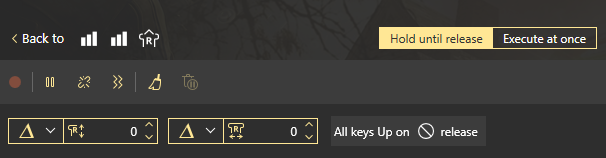

        It is possible to disable recoil compensation combo with additional shortcuts of [LT High] + [RT High] + [R Up/Down/Left/Right] or [R-Stick Low/Med/High] with this combo:
        It will reset relative deflections once you go out of the right stick deadzone, And once you release the right stick, recoil combo would start again. The 450ms delay for -5 might be a problem though. Don't have any ideas for that.
