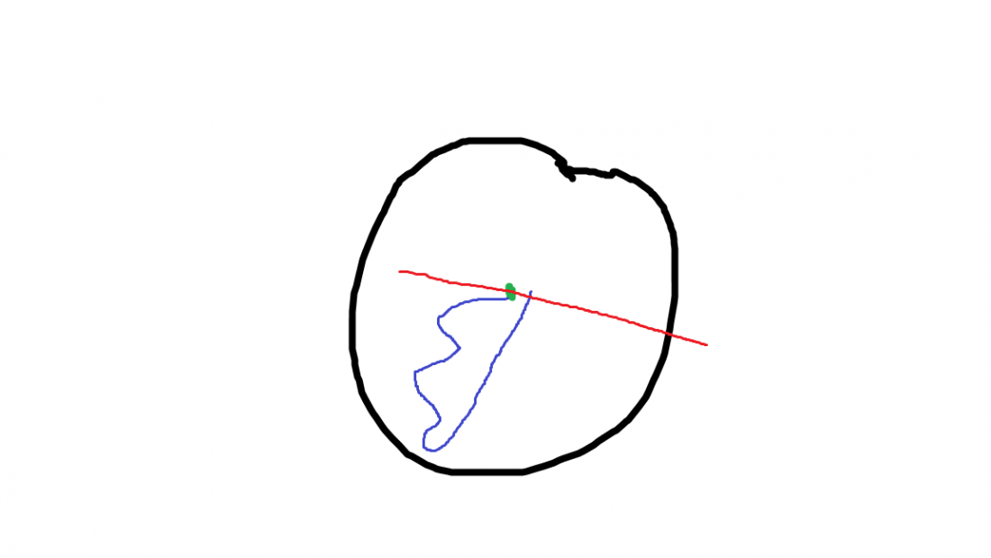

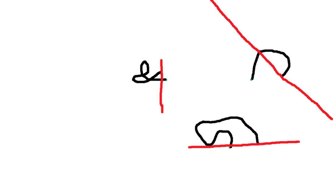

        GREAT IDEA! I'm sending you 3 drawings simulating my issues through Paint.
        Green dot - Start
        Black line - mouse movement
        Red line - The wall
        Hope the paint sends.
        • #34
          Here's a radial drawing. Everything is in continuous motion.

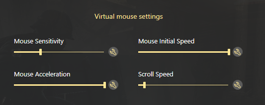

            Hello there!
            I have tried to reproduce the same movement with my dualshock, and I never faced any issues with this, no sorts of 'walls'. Just smooth mouse movement. Applied the same config as you have.
            Using Dualshock + PS4 Wireless connector. This is all I have right now.
            Try making settings of the virtual mouse, same as mine. Probably this will help. If not, I think that the issue is in the physical stick itself. Might also be USB port or a BT receiver issue.
            Click image for larger version  Name:	1.PNG Views:	0 Size:	61.0 KB ID:	222154
            • #36
              Hello back!
              I appreciate the suggestion, but I have those exact settings myself, with the sensitivity valued at 10, although default 4 was the same. My concern is starting to be, perhaps its my controller? I'm just trying to make sure, before I go and purchase a new controller. My Dualshock is close to 4 years old, but that still seems not likely relevant...yet. Although I could be wrong, but if no one else has a sudden drop with looking around, idk =/

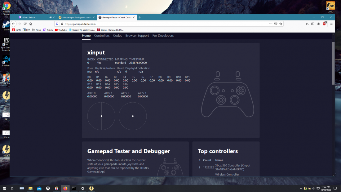

                        If you change your response, it may be the reason why mouse moves differently. However, doesn't seem to be the reason of the mouse getting stuck.
                        Could you check your controller (without reWASD with remap turned off) in https://gamepad-tester.com/ ?
                        Maybe there is something unusual with the device itself?
                        Today we have tried to reproduce this thing again on a few different DS4 controllers, and there is nothing still, I am sorry.
                        • #42
                          Ok two screenshots. Where the stick pitches slightly left is the Right Joystick as a controller is unmapped. The centered one is through the Mouse input.
                          • #43
                            The joystick lean would've settled it, but the Left stick gets stuck when it was changed all the same. The left stick stays centered no matter the input.
