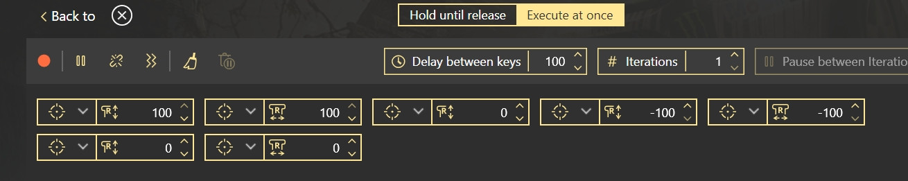

    REWASD currently doesn't have an option to record Gamepad right/left sticks movement on Key Combo. I'm wondering how can I program it to make the right stick do a full clockwise spin.
    It should look like this one or something similar:

    Stick goes Up, then stick goes Up+Right, then Stick goes Right only and so on.
    You may need to add Delay between keys (100ms on my screenshot), so the movement is done at a normal pace.

      This is exactly what I need. Thanks!
        You're welcome. Have a great gaming experience.
