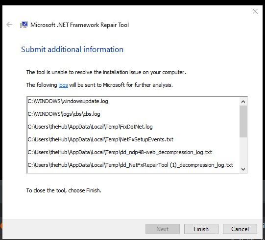

    Attempt to run Microsoft Net Repair: please see screenshot attached.

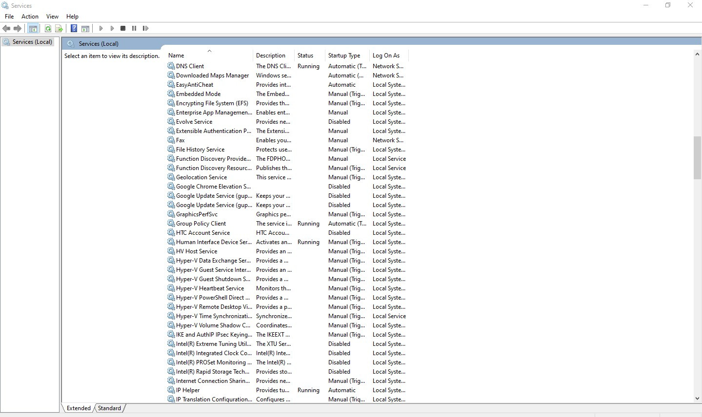

    1. Please, go to the Services, find the Gamepad Controller Mapping services, and check the service status. Please start it manually if it's stopped. Any error pops up? Report the error message during the attempt to start service - https://prnt.sc/saitqz

      1. The Gamepad Controller Mapping Service is missing? Please see attatched.

                Ok last one, I'm just trying to give as much info as I can. I tried the repair tool and got this
                C:\WINDOWS\windowsupdate.log
                C:\WINDOWS\logs\cbs\cbs.log
                C:\Users\theHub\AppData\Local\Temp\FixDotNet.log
                C:\Users\theHub\AppData\Local\Temp\NetFxSetupEvent s.txt
                C:\Users\theHub\AppData\Local\Temp\dd_ndp48-web_decompression_log.txt
                C:\Users\theHub\AppData\Local\Temp\dd_NetFxRepairT ool (1)_decompression_log.txt
                C:\Users\theHub\AppData\Local\Temp\dd_NetFxRepairT ool_decompression_log.txt
                C:\Users\theHub\AppData\Local\Temp\Microsoft .NET Framework 4.8 Setup_20201101_173140381.html
                C:\Users\theHub\AppData\Local\Temp\Microsoft .NET Framework 4.8 Setup_20201102_180546164.html
                C:\Users\theHub\AppData\Local\Temp\Microsoft .NET Framework 4.8 Setup_20201102_181006427.html
                C:\Users\theHub\AppData\Local\Temp\FixDotNet_HKCR_ Installer.regdump
                C:\Users\theHub\AppData\Local\Temp\FixDotNet_HKLM_ Installer.regdump

                  Checking the system info found lots of application crashes. It seems that something is not going OK in your system. I post the article that describes how to repair or re-install the NET framework (steps 3 and4). Please, proceed with these steps (however clean boot, Sfc, Chkdsk commands are also good to run).
