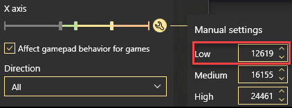

  • Support Agent
    replied
    You should ignore the [Response] curve and keep raising the deadzone, that is a [X axis: Low] value in [Advanced] settings, until the problem dissapears:
    Click image for larger version  Name:	image_2020-11-17_234836.png Views:	0 Size:	12.4 KB ID:	222356

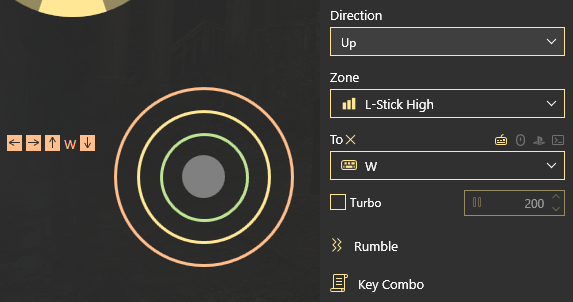

    If problem stays, you can try resetting stick to [Default settings] and then map WASD to corresponding directions of [High] zone:
    Click image for larger version  Name:	image_2020-11-17_235322.png Views:	0 Size:	91.5 KB ID:	222357
