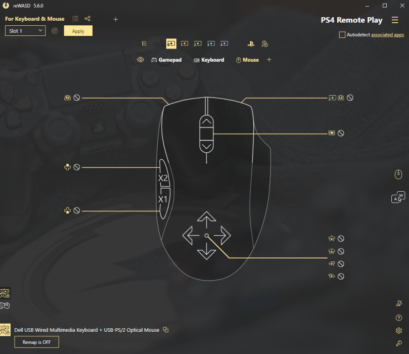

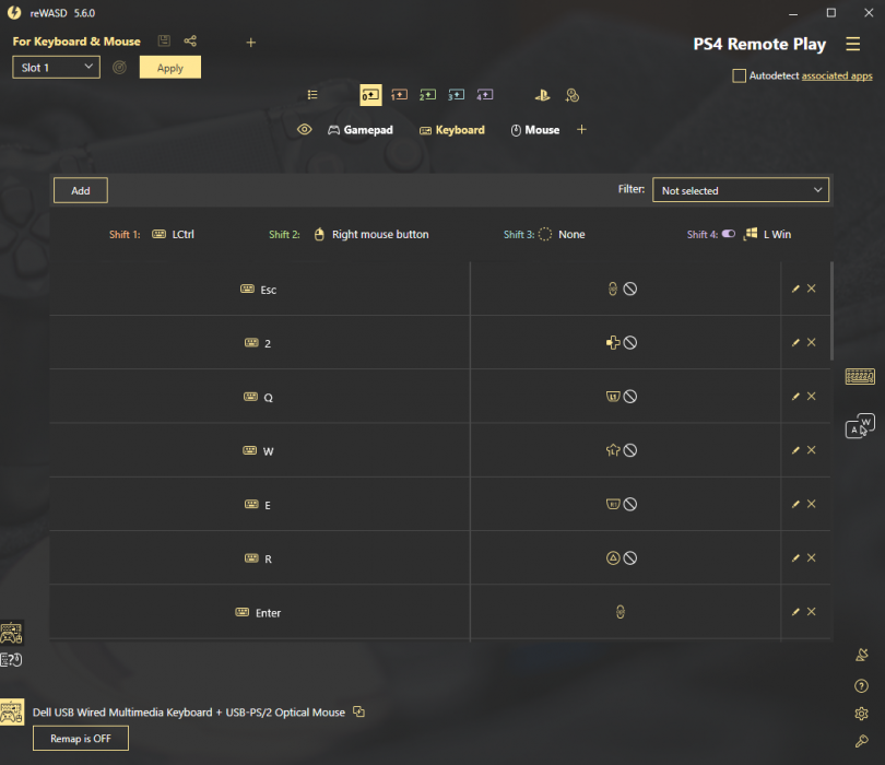

      Not sure what all you need, but here's a few to start off. Let me know what else would help.

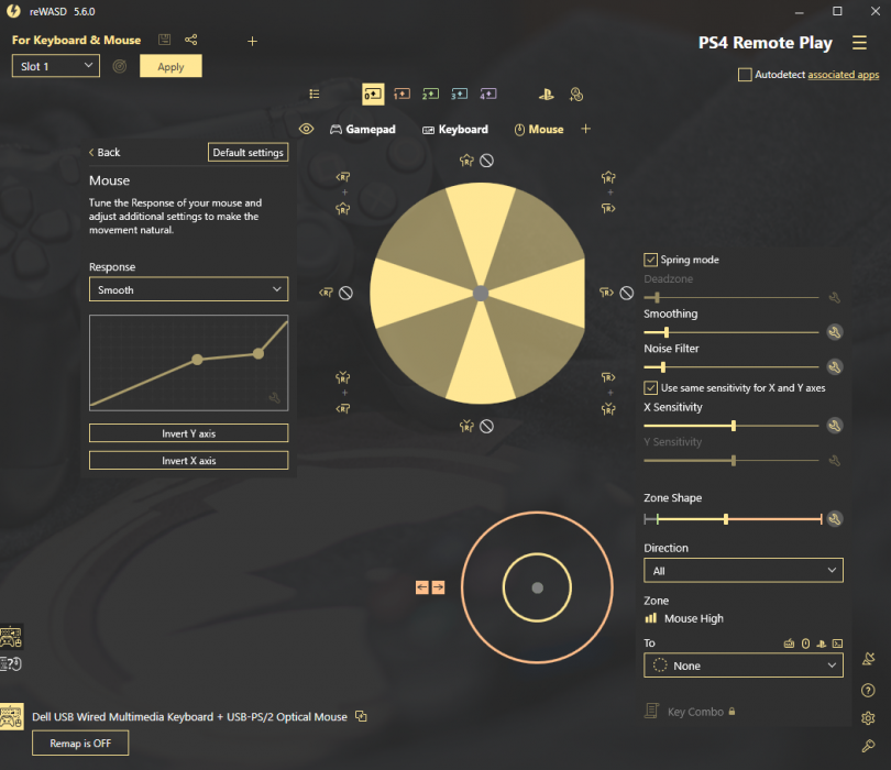

              Deadzones or [Deflection Low] values for both sticks of [Virtual gamepad] are different from default values. Try setting them back to 7000 (the [Wrench] icon).

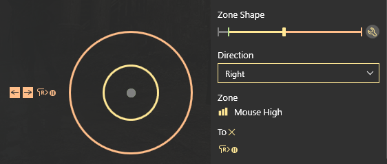

              You can also remove two zone-mappings for "inertial turn" here:

                So after playing around for a bit, it seems to be an issue when I have Spring Mode ON. I'm adjusting the Spring Mode OFF setting to better accommodate how I want to control, but Spring Mode is my preferred way to play.
