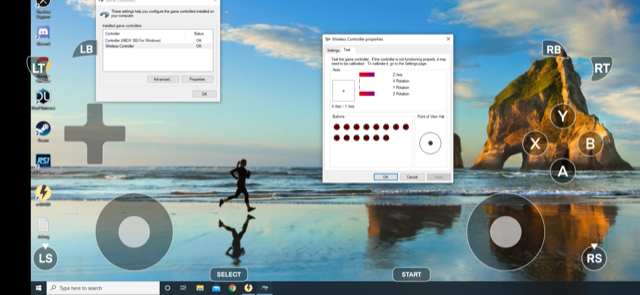

          The game I'm trying to get to work is Dual Universe. I checked and it does not have controller input game settings. I've attached pictures to hopefully help, but I tried to do as you said and the Wireless Controller did show up, but the mappings did not work.

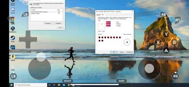

          The mappings did work for the Xbox controller for Windows above the Wireless Controller option. I uploaded pictures so you can see.

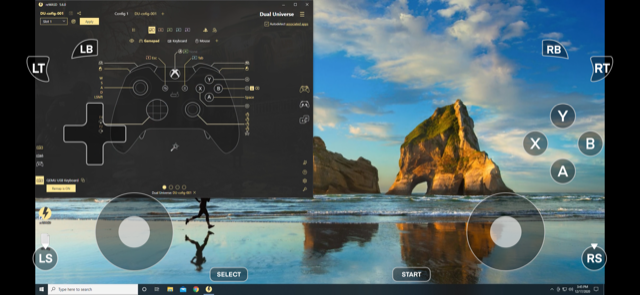

          I also uploaded a picture of what I see when i open Rewasd.
          Hopefully this can help you point me in the right direction.
