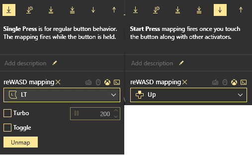

    1. Aim down sights and ping (left trigger hold, d-pad up once)
    - Desired behaviour: when I hold left trigger, I want normal trigger hold behaviour (i.e. keep firing), and the d pad up to fire only once
    - Observed behaviour: D pad up fires correctly once when trigger is pulled. LT is also pulled. When LT is released, LT keeps firing and doesn't release. I can't get the LT to untoggle i.e. it's permanently stuck down, even if I keep pulling the trigger. D pad continues to work correctly on subsequent LT pulls but LT doesn't seem to change.

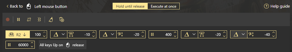

    2. Anti recoil (pull right stick down when RT is held)
    - Desired behaviour: on single pull, just fire RT once. On pull and hold, continuously fire RT and also pull right stick down.
    - Observed behaviour: first few single pulls worked fine (right stick didn't pull down). First pull and hold worked fine i.e. right stick pulled down and gun fired. Then tried to rapid fire i.e. pull RT multiple times in quick succession. The long press combo fired when it shouldn't have (I was single pressing). Then right stick gets "stuck" in the pull down state as if I haven't released RT. Stick keeps pulling down and I can't stop it. The RT isn't firing so the gun isn't shooting, just the stick is pulling down continuously.

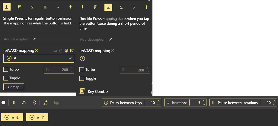

    3. Auto bunny hop (repeat press A on double tap of paddle)
    - Desired behaviour: on single paddle pull, fire A once. On double tap, fire A 5 times.
    - Observed behaviour: single pull works fine. Double tap just fires A once (no combo iteration).

        #3 No such mapping was set in the config attached, so made it based on the screenshots. Works fine. But the problem might be that it's working way too fast for a game, as you get 5 taps within 100ms. You should increase pause between iterations and keys to value higher that 18ms. Might be easier to just use [Turbo] and increase pause value until it works properly in game.

            Excellent thanks! #3 - works with turbo, should've done that in the first place anyway.

              A) I think you're talking about [Combo] with [Turbo] flag enabled here. But if you want a [Combo] that changes stick deflections with time, then you need to make one in [Hold] mode with pauses between changes in stick deflection and a very long pause at the end. Should be similar to this:
              Click image for larger version  Name:	image_2020-12-20_235928.png Views:	0 Size:	43.9 KB ID:	223015
              It will hold down at 10x20% for 400ms, then 20x40% for a minute (or until you release the button). Add more pauses and deflection changes if needed. Just make sure the last node is a pause and it is a long one.

                Got it thanks. I can't quite get the behaviour I want for the more advanced recoil control using the method you outlined - it seems a bit random. But to be honest there could be some random behaviour of the in game recoil rather it being the software.
                When I try your method on xbox elite 2 controller it actually feels like the relative stick movements are stacking, so in your example it would be -10x-20 for 400ms, then additional -20x-40 to take you to -30x-60 until release. Again, hard to test in game issues vs the software respone, but generally what I've found is I would have to set the first movement to be negative, then the second movement to be positive (up and right), to offset the first movement. Kind of weird.
                Cheers
                  I've mistaken this case with another one, so last pause is not required here, but it being there won't change anything either. Relative deflections are indeed stacking up, so you'll have to keep in mind resulting deflection value between nodes in a combo.
