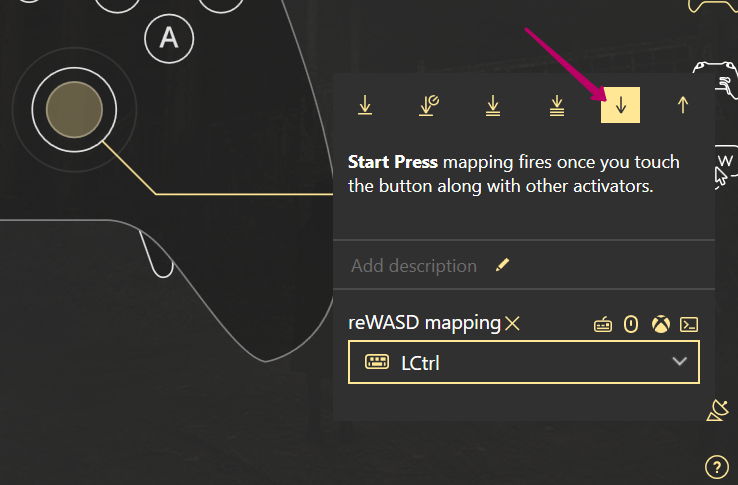

        Hey there! If I understand you correctly, you want to press a button and get a mapping immediately, but it should also stop before you release the button.
        If yes, please use Start Press activator here:

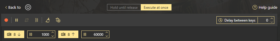

            I assume, that you want for [8] key to be released once you hold [A] button long enough, and not just to hold it for certain amount of time every time you press or tap [A]. It's tricky, but possible. You will need both [Combo] and [Rapid fire] features. For this to work you have to set this [Combo] on [A] button:
            Click image for larger version  Name:	image_2021-01-08_032450.png Views:	0 Size:	43.0 KB ID:	223452
            And also set a [Turbo] flag on it. In this case its value doesn't matter.
            First pause is the time before [8] key gets released. Second pause is needed to counter [Turbo], as instead of its main purpose its quirk to stop the combo when button is released is used.
